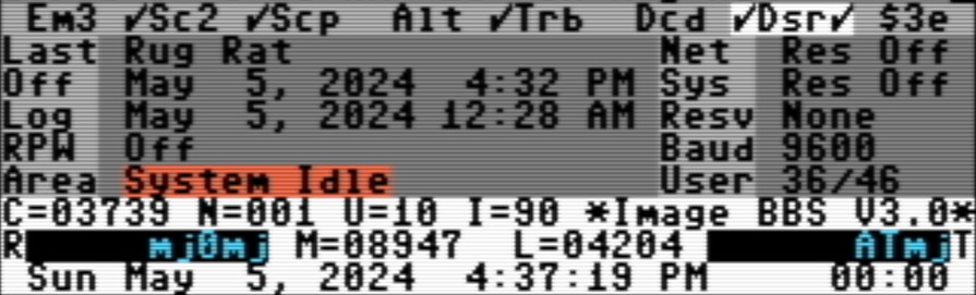

You need to place a checkmark on the left side of Dsr on page 6 of the Litebar.
Press f6 3 times.
Now press f5 4 times until Dsr is highlighted.
Press 5 f7 to place a checkmark on the left side of Dsr
Your screen will look like the picture below.

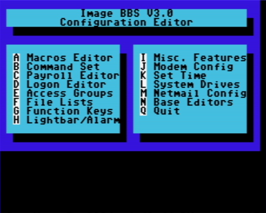

If you have the current IDLE MODs installed you can enter the Image BBS! Configurator by typing Shift I at the Idle Screen. If you do not have the IDLE MODs installed, you must login to your BBS in Local, or Psuedo Local Mode.
Once in the Image BBS Configuration Editor, type H for Lightbar/Alarm.
Image BBS configuration Editor.jpg (128.67 KiB) Viewed 13508 times
Type A for LightBar Defs

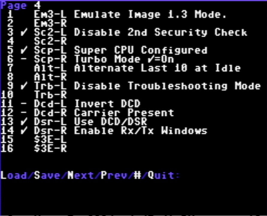

Type N then Return 3 times until the Page # on the top says Page 4.
Image Lightbar Defs Dsr.jpg (96.56 KiB) Viewed 13508 times
If 13 is already checked from the previous step, simply type S then (Return).
If it is not already checked, because you came straight to this step, or you are making the change remotely. Simply Type S then Return to save the defaults.
