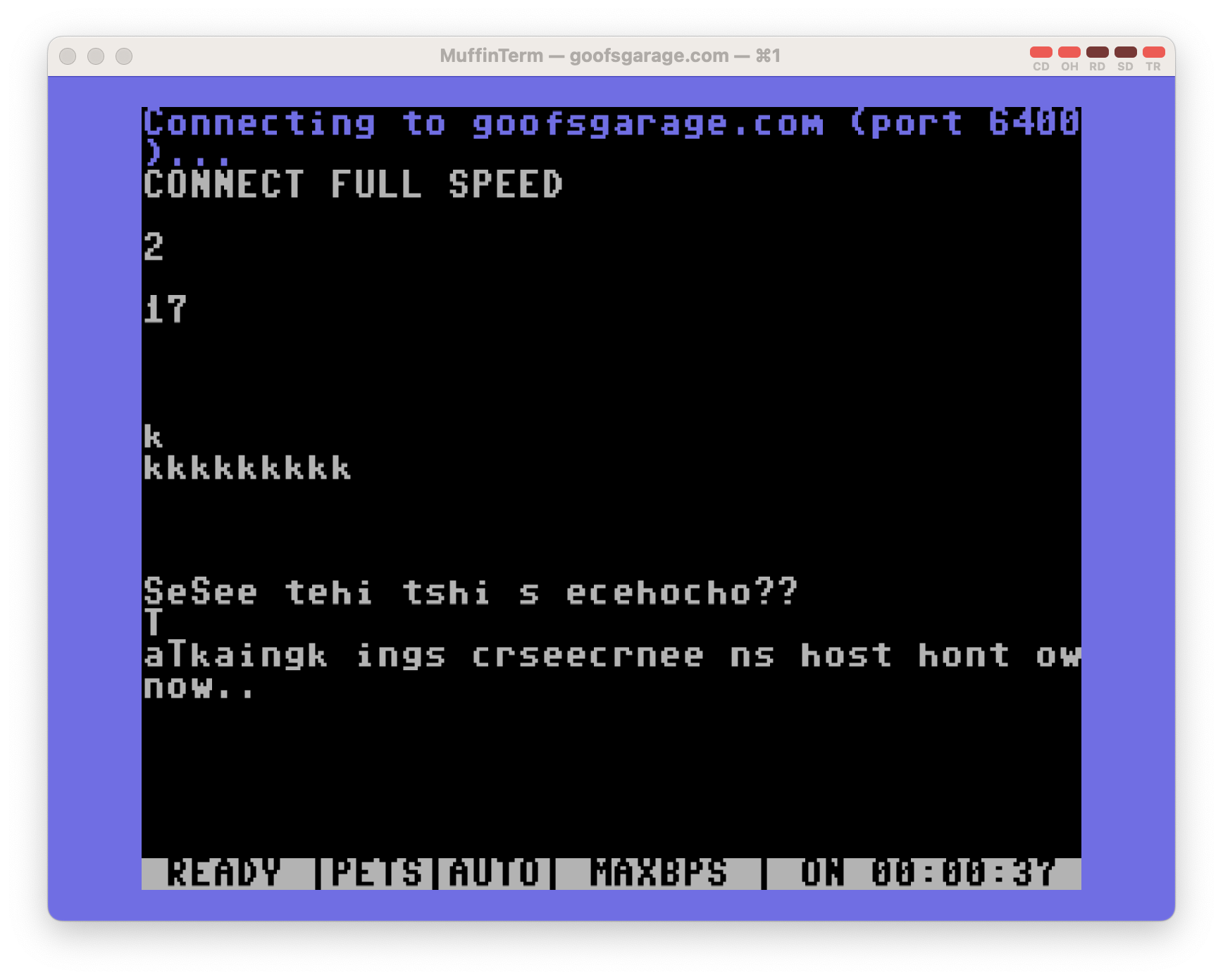

Hi Brent, I saw your feedback. Can you post a picture of what you are seeing here?
Re: Goof's Garage Echo in Muffinterm?
Here you go.
Screenshot 2023-06-28 at 7.52.45 AM.png (299.01 KiB) Viewed 18567 times

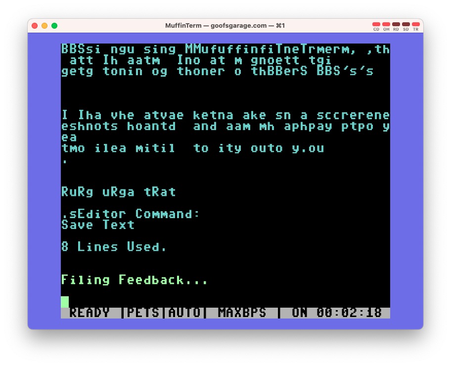

Here is a better example. The above just looks like I am drunk in Chat!

That is really strange. Everything you typed looked normal on my end - I heard you log on earlier and tried to catch you in chat but just got the chat check mark set after you'd already logged off, so when you went to log on the next time, it dropped you straight into chat.
X-Tec has been on the board a few times and never mentioned anything, and it seems fine when I connect with CGTerm. Unfortunately I don't have much of a userbase at the moment... ;)
I'm not suggesting this as a fix, just a means of troubleshooting: Have you tried a different terminal?
It is odd because it does not appear to be a consistent echo. IE: You are not getting two of every character you type, or if you are - perhaps after a varying delay. I do notice a bit more delay / lag when I type messages on your board as opposed to others - which makes sense given the greater distance of travel (which is still insanely fast considering the there-and-back-again distance!) but I wonder where the "extra" returned characters are coming from. I should have taken a screen shot of my end for comparison because I saw what you had typed there perfectly. So from there, either Image sent back strangely echoed characters, tcpser sent back strangely echoed characters, or something in your terminal displayed strangely echoed characters.
I have restarted both tcpser and Image - not sure if that will make any difference but I'm shooting in a lot of directions in the dark, trying to find something to home in on as a potential cause.
