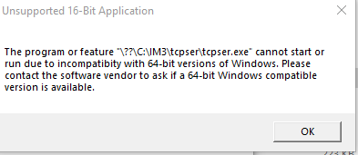

tcpser error.PNG (6.42 KiB) Viewed 18960 times
This is the error I get when I try to use the tcpser file that I downloaded from here.
Re: C-Net 64 DS2 + Vice 3.6.1 + tcpser
Thanks X-Tec for posting that screen shot. What version of Windows are you running it on? Is there any chance you are in the Windows Insider program or X-Box Insider?
I received the exact same error with Windows 10 64, I am not in the insider program for Windows 10.
Hi Brent,
It seems like for some, this error is occurring while for others it is not. Unfortunately, I have not been able to replicate the problem so I am reliant on feedback from those like yourself for whom this does occur.
I was able to replicate the error message itself by creating an empty text file, changing its extension to .com and then trying to run it. I suspect that something is preventing the actual contents of the .exe file from reaching the operating system, possibly either UAC or Anti-Virus software. If you have AV software installed, can you check its logs and see if it reports anything related to vice or tcpser? If not, can you check the Windows event viewer and see if again, there is anything there related to either vice or tcpser?
Or, if you have the resources (including a lot of free time on your hands) - could you try running vice / tcpser on a fresh, clean install of Windows on either a new VM or a blank hard drive in a physical PC? The thing is that I know this works because I've done it several times, and it would at least prove or disprove whether or not the software will work for you if there is nothing else installed on Windows. If it does work for you on a clean install, then we just need to figure out what software is conflicting with it, why, and then figure out what to do about it.
.... or, if someone else wants to take a crack at compiling the code for Windows, that is definitely an area I am not very familiar with. Perhaps there is some setting or parameter that is necessary but not obvious when compiling that someone with more experience would be able to look at and go, "Oh I know how to fix that..." whereas compiling for Windows is entirely new to me.
