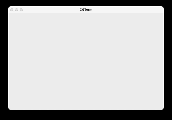

Well, if I had actually participated in the Mac OS public beta program I would have known this ahead of time, but CGTerm 1.8 no longer works on Mac OS X 11 Big Sur! On Execution you are presented with a blank white screen (Though the App is actually functioning normally).
CGTerm 1.8 Big Sur.jpg (17.95 KiB) Viewed 16884 times
Strangely enough, compiling the 1.7b2 source functions correctly! (I say this is strange because with Catalina the white screen happened after compiling CGTerm 1.7b2, but 1.8 functioned flawlessly!)
