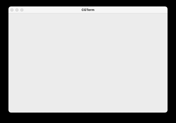

Well, if I had actually participated in the Mac OS public beta program I would have known this ahead of time, but CGTerm 1.8 no longer works on Mac OS X 11 Big Sur! On Execution you are presented with a blank white screen (Though the App is actually functioning normally).
CGTerm 1.8 Big Sur.jpg (17.95 KiB) Viewed 16879 times
Strangely enough, compiling the 1.7b2 source functions correctly! (I say this is strange because with Catalina the white screen happened after compiling CGTerm 1.7b2, but 1.8 functioned flawlessly!)
The drawback to 1.7b2 is that the keyboard mapping is not correct. If you must use CGTerm 1.8, you will either have to install OS X Catalina on a virtual machine, install Catalina on a separate partition, or delay upgrading to Big Sur.
The instructions for comping the 1.7b2 source are here.
