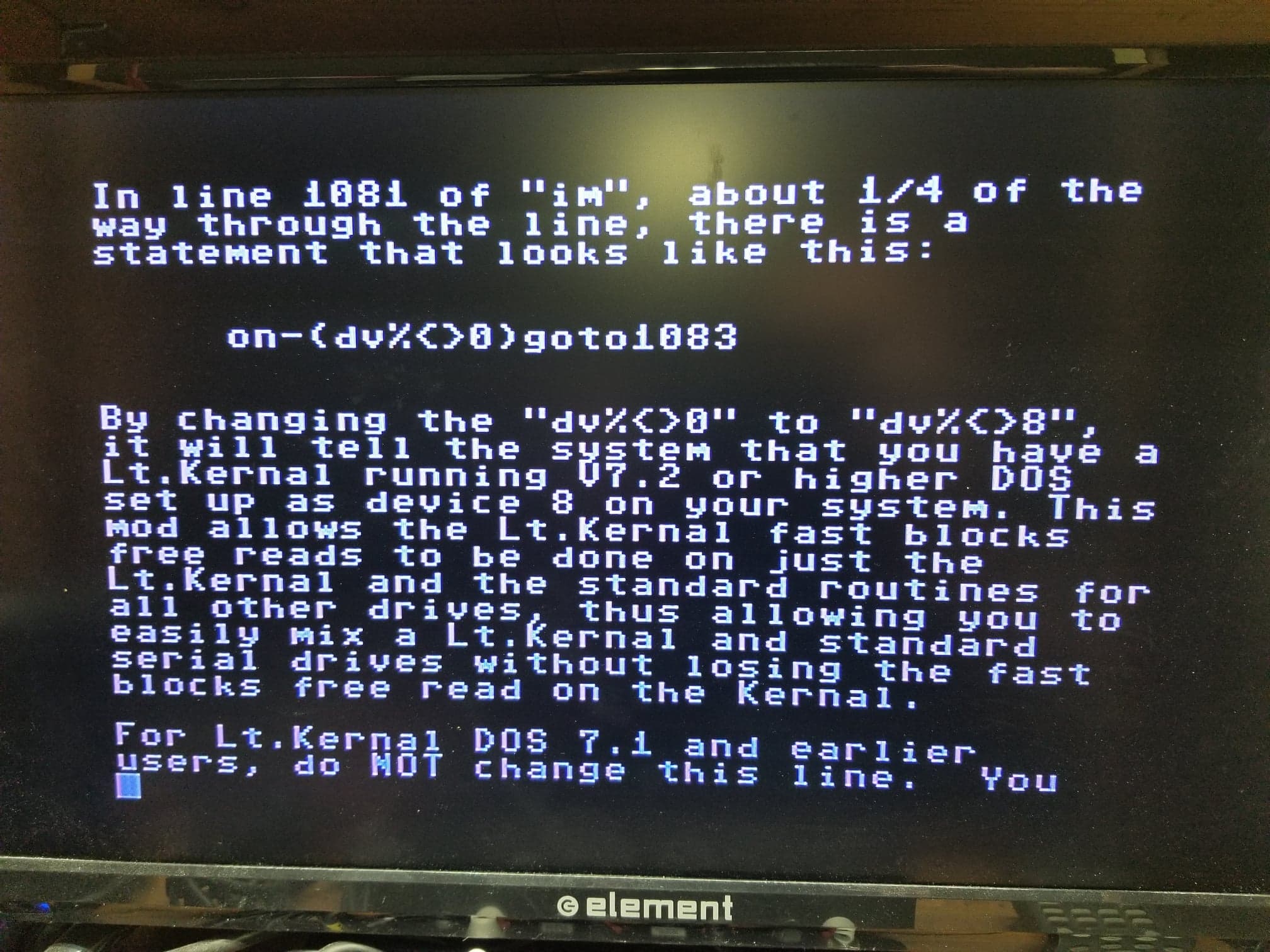

Are you running your IMAGE BBS 1.2 on a LT Kernel or Read Admiral HyperDrive?
Are the blocks free on all your LUs displaying 65525?
If you have Lt.Kernal DOS 7.2 or higher (You do not need to worry about this with he Rear Admiral HyperDrive. You can make a simple change to your IM file to fix this.
Load your IM file.
[bd] = LU of your boot drive.
[dv] = device # of your LT Kernal/Rear Admiral HyperDrive
load"[lu]im",[dv]
List line 1081
LIST 1081
You should see this somewhere in the line.
on-(dv%<>0)goto1083
Change the (ZERO) in the line to match the device # of your LT. Kernel. For example, if your LT. Kernel is configured as device # 9, the line will read like this.
Image BBS blocks free fix.jpg (304.35 KiB) Viewed 6442 times
on-(dv%<>9goto1083
Load Image 1.2, and your blocks free should now be displaying properly.
