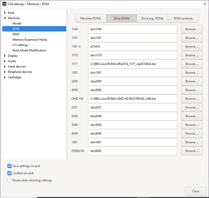

Go to Preferences > Settings > Machine > ROM
Click on the Drive ROMs tab.
Looking at the list of Drives, you will see the CMD HD. Click the browse button to the right then locate your CMD Hard Drive Boot ROMs. Double Click on the file in the list to the left, or single click and click the Open button in the lower left hand corner.

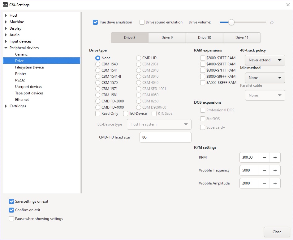

We should be taken back to the settings window. Click on the triangle to the left of Peripheral devices, and select Drive.
Here we will choose which device # we want our CMD Hard Drive to be - 8,9,10, or 11. I have chosen Device 9. Click on the corresponding tab, and click the CMD HD radio button.

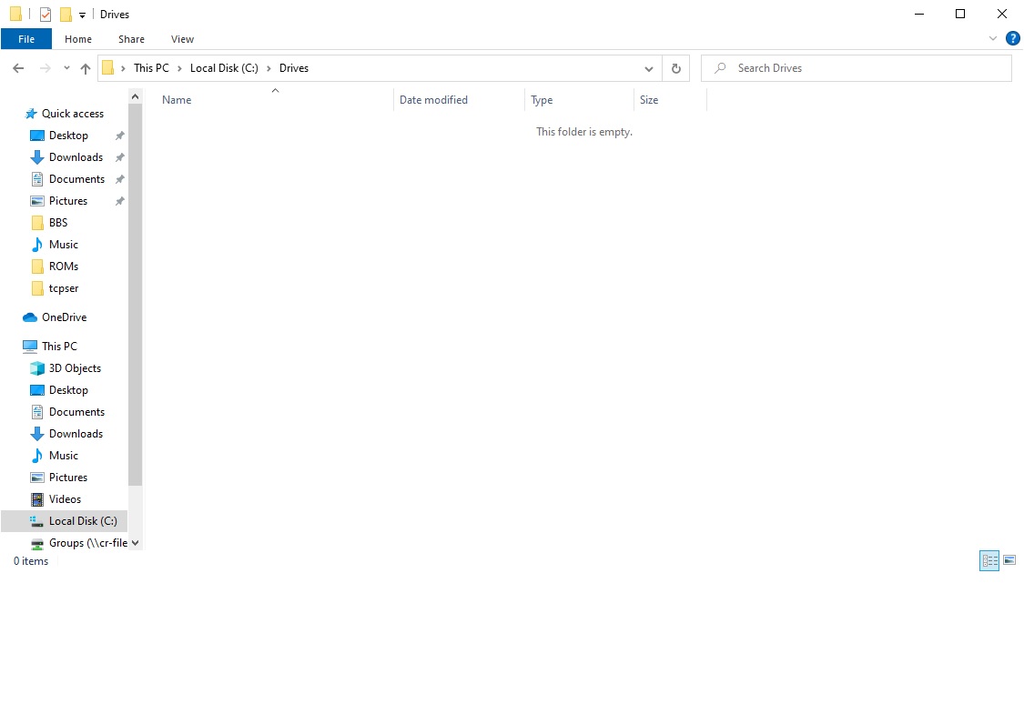

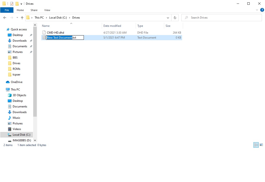

First we must decide where the Hard Drive File will reside. Go to your File Explorer, and choose a place for this file to live. For the sake of this demo I will use C:\drives (you can create it anywhere you want..).
Create a blank text file. Right click anywhere in the file explore window and left click on New > Text Document.
Empty drives folder.jpg (61.53 KiB) Viewed 24866 times
A new notepad file will appear.
New Text Document.jpg (73.89 KiB) Viewed 24866 times

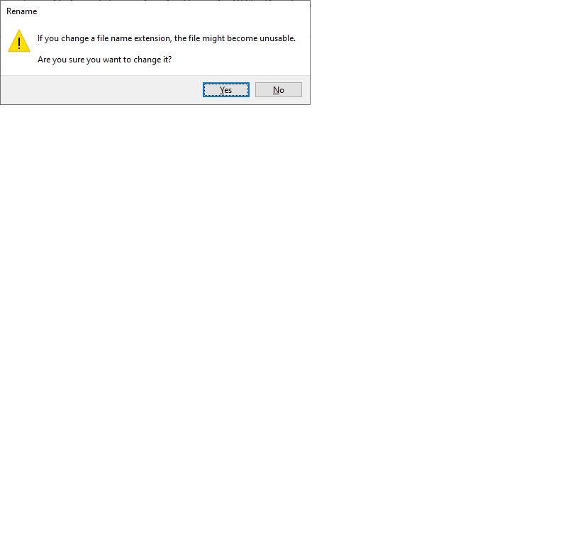

Rename it CMD-HD.dhd (replacing the .txt file extension).
Click YES in the dialog box that will appear.
Change file type dialog..jpg (26.74 KiB) Viewed 24866 times

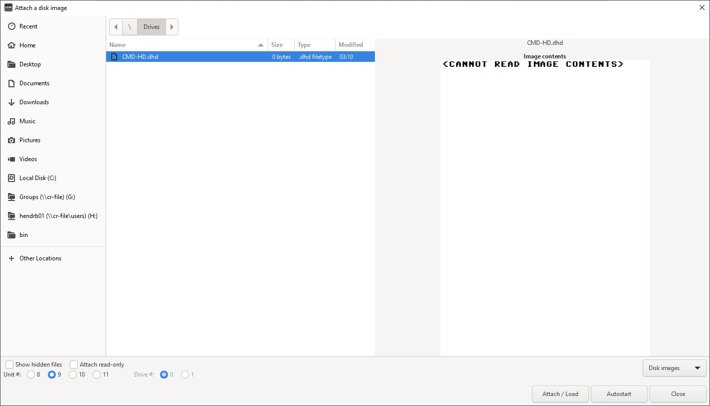

Okay! Now we have our Hard Drive .dhd file created.. Now we have to attach it, and format it so the CMD-HD will know what to do with it.
Go back to VICE.
Select File > Attach Disk Image > Drive 9
VICE - Attach hard disk image.jpg (87.41 KiB) Viewed 24866 times

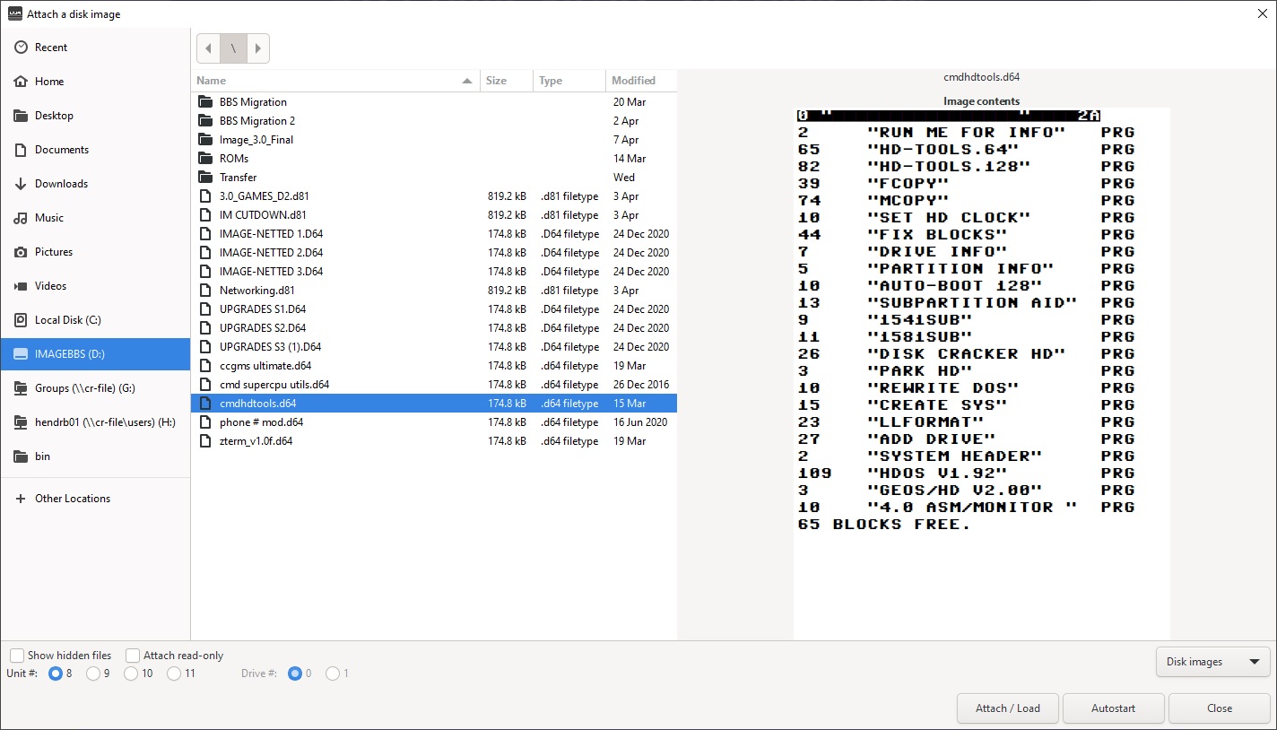

You're Image file is now attached.. Yes I know the drive is still blinking.. No problem! We now must format the drive using the utility provided on the cmdhdtools disk image.
Mount the cmdhdtool.d64 image in drive 8.

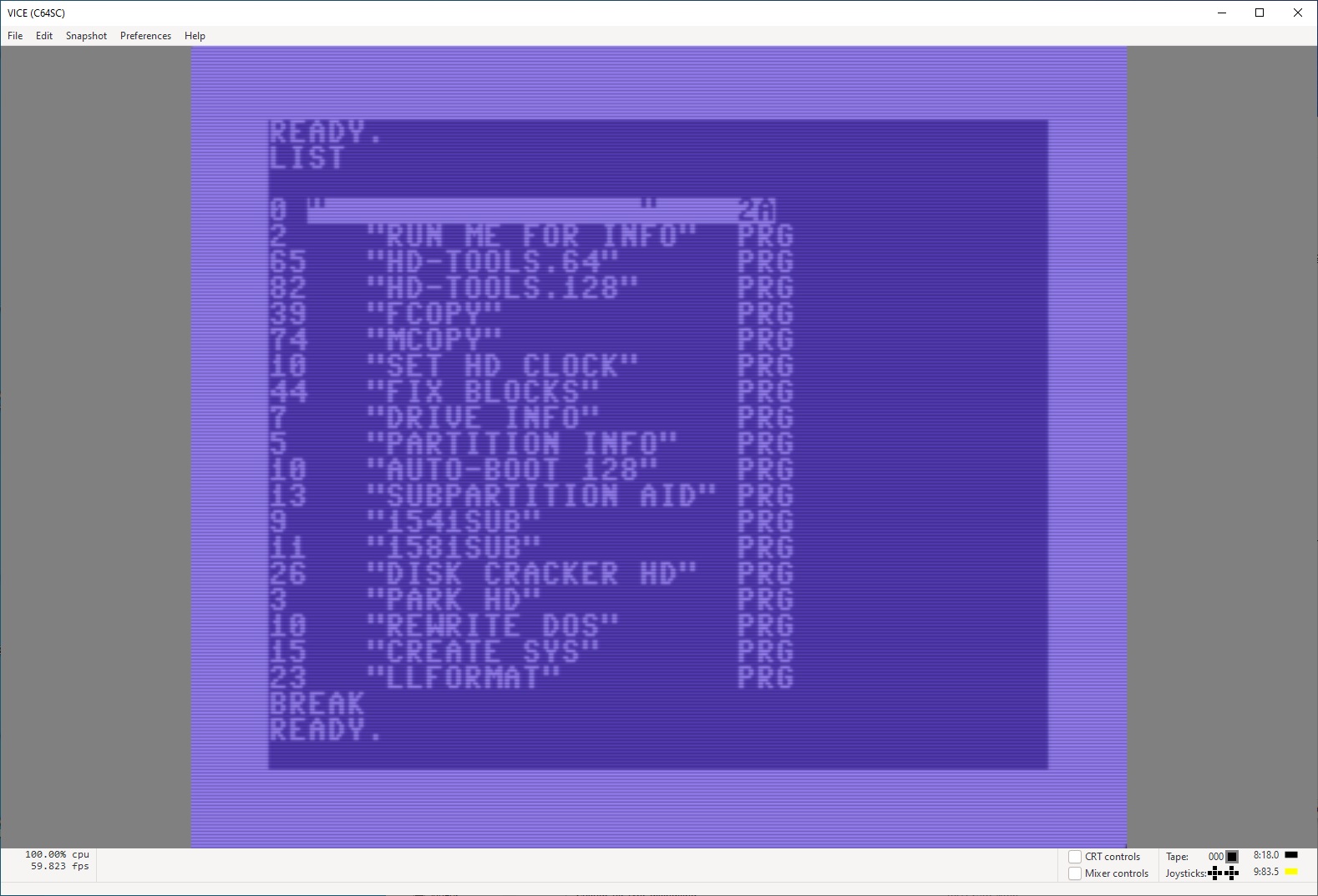

We want to load the create sys.
So type LOAD"CREATE SYS",8,1
Type Run.
Hit Enter..

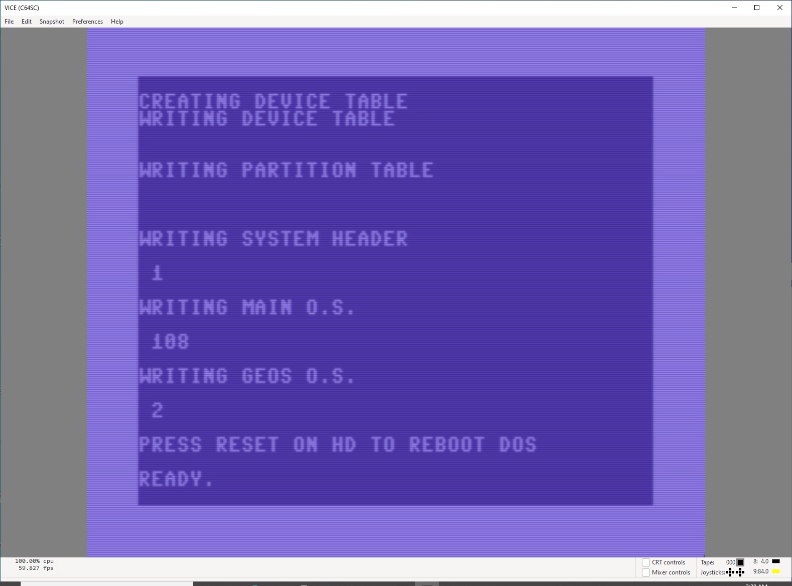

I am not sharing the hard drive with other systems, so I answer N at the next screen.
Let Create Sys do its thing. When it is done your screen will look like the picture below.

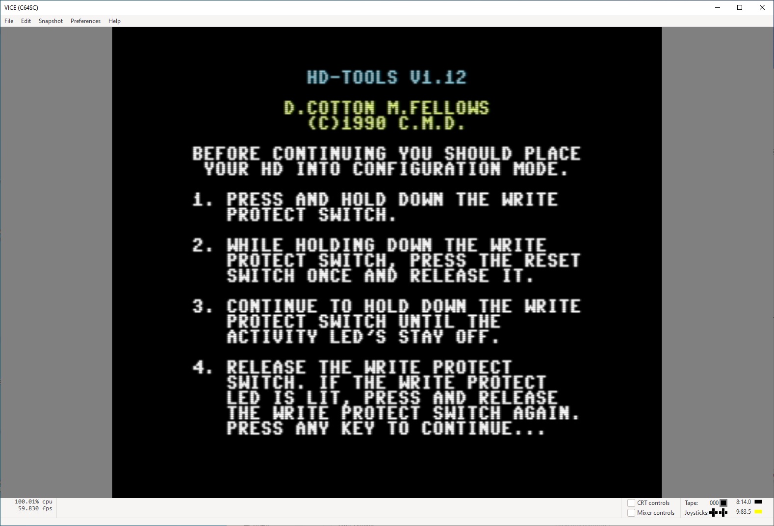

Place the drive in "CONFIGURATION MODE"
Look on the bottom right hand on the VICE screen and find the drive # you have configured for your CMD HD. In my configuration I use device 9
Left click the drive # in your status bar.
Configuration Mode.jpg (211.86 KiB) Viewed 24866 times
Click Reset Drive #9 to Configuration Mode.
Press the "ANY" key.. To continue... :)

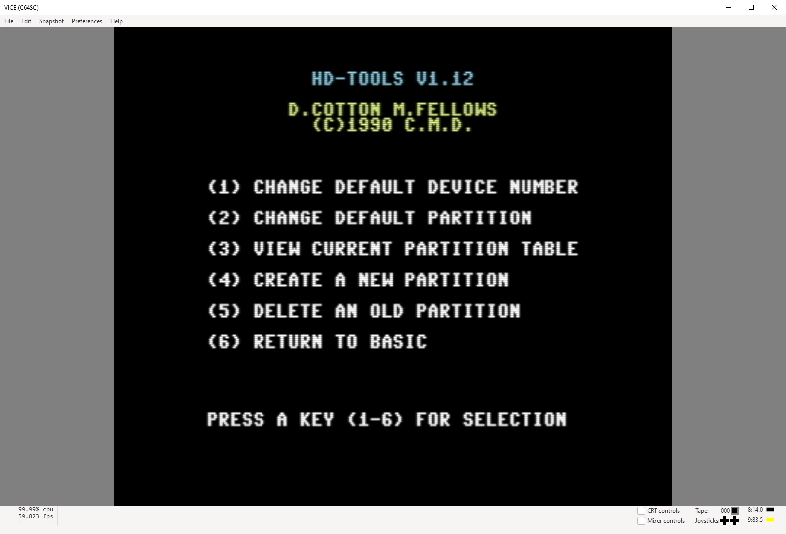

HD-Tools Menu.jpg (143.25 KiB) Viewed 24866 times

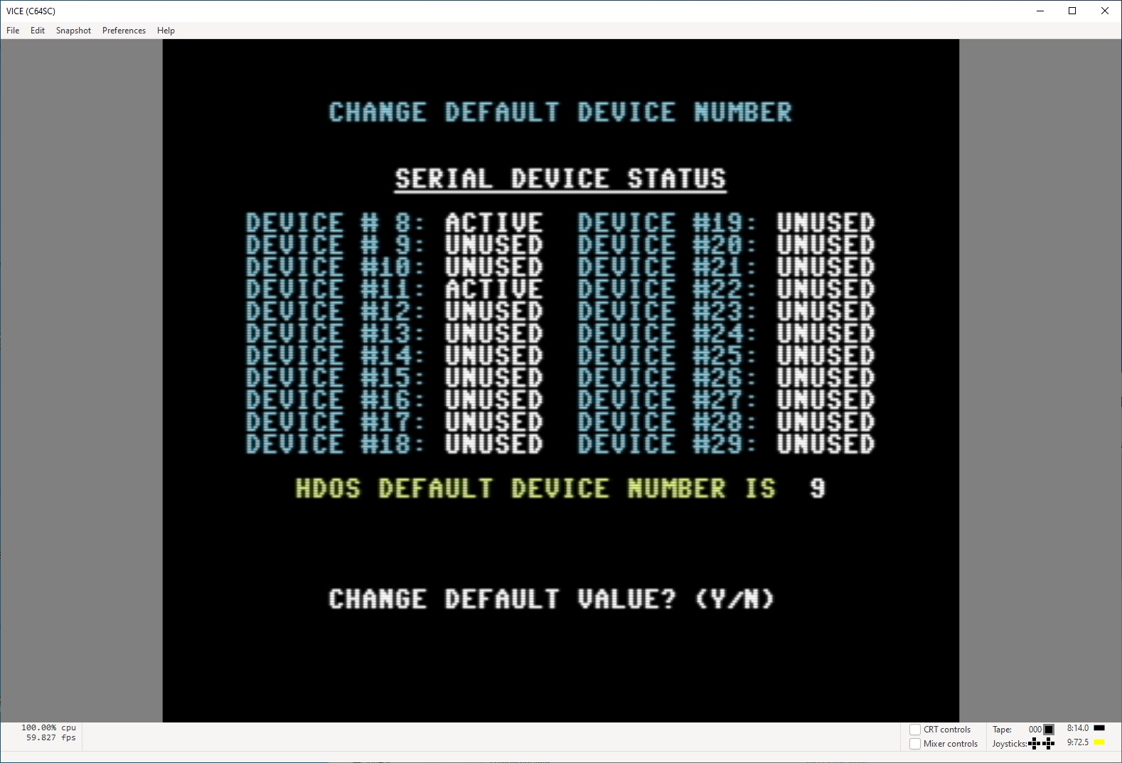

Start out by setting the Default Device #.. Press 1.
Default device.jpg (229.09 KiB) Viewed 24866 times
You will see the device is already set to 9. So I will choose N.
Moving along, let us select #4 to create our first partition.

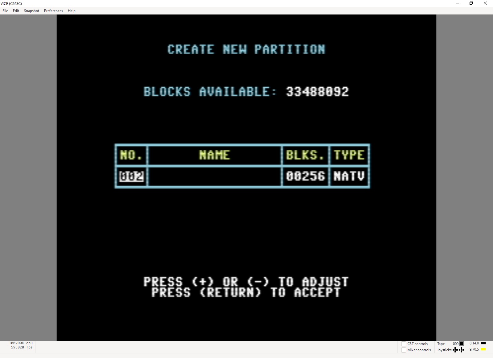

So now lets create a partition.

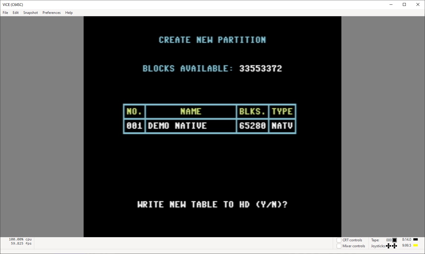

First your cursor will be on Partition type. Just hit enter on the default here. You use your minus (-) or plus (+) keys to select one of the 7 partitions types noted above.
Next, lets create a 16MB (Maximum size.) partition. press your minus key (Unless you want to watch the numbers spin up to 65280. Press Enter.
Now, let's name the partition.. I use DEMO PARTITION FOR THIS DOCUMENTATION, you can name it anything you want. Enter the name and press ENTER.
Demo part.jpg (100.71 KiB) Viewed 24866 times
Once you are finished answering the above, you will be asked to write the new table to the HD. Type - Y.
If the partitioning was successful, you will be presented with the following screen.
default create part.jpg (123.67 KiB) Viewed 24866 times
